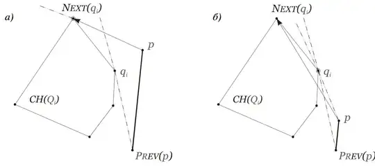

I doubt that it is necessary to perform this binary search for every candidate-point $q_i$ on each iteration. I get that, when we just start with $p_0$, there's no other way to do this. What about the following iterations? As I think of it, on each iteration the point $q_i$ either stays the same or it changes to one of the successive point of $Q_i$ in ccw-order. And one point cannot become a candidate more than twice (or even once?). If that is the case, why can't we use $K$-pointer technique and just set $q_i \leftarrow q_{i + 1}$ while $q_i$ is not a tangent line for current iteration. There shouldn't be more than $2m$ candidate changes for each $Q_i$ for all $m$ iterations. Wouldn't the resulting complexity $\mathcal{O}(Kh + Km)$ be better than $\mathcal{O}(Kh + Kh\log m)$?

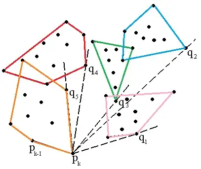

And some pictures that aren't on wiki page to give a better idea of this second phase. The first one shows what are the candidates. enter image description here
And the second one should provide an intuition about choosing $q_i$ for the next iterations.
