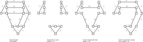

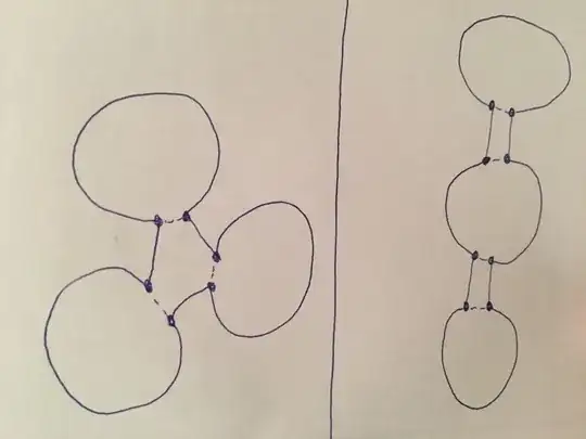

Attached are some examples. In the left figure a 3opt move is optimal, while in the right figure a sequence of 2opt moves is best.
Here is a numeric example that I constructed. Using the optimal merging method we get a weight of 43, while the greedy algorithm gives us a worse solution of weight 50. Even if we join the bottom cycle by removing the new edge we added (weight 10) we would still get a worse solution (I didn't draw it for clarity).

This is NOT an answer. This post is just to construct a concrete numeric example out of the left diagram in the picture in the question.
(This answer, too long to fit as a comment, was requested by a user who wanted to see a concrete numeric example which his greedy algorithm may fail. It was written about the same time when OP added a numeric example that is exactly the same except a slightly different weight assignment.)
Let $G$ be the complete undirected graph on 12 vertices $A_1, A_2, A_3, A_4, B_1, B_2, B_3, B_4, C_1, C_2, C_3, C_4$.
Let $S$ be the set of the following three simple circles.
  • the circle $c_A$: $A_1, A_2, A_3, A_4, A_1$.
  • the circle $c_B$: $B_1, B_2, B_3, B_4, B_1$.
  • the circle $c_C$: $C_1, C_2, C_3, C_4, C_1$.
All edges in the three circles weigh 1. The edges $A_3B_2, A_4B_1, B_3C_2, B_1C_4, C_3A_2$ and $C_4A_3$ weigh 2. - All other edges weigh 16.
We are allowed to merge two cycles by removing an edge from each cycle and connecting them up with two new edges, repeatedly until we reach a single cycle. The goal is to reach a cycle with the smallest total weight.
A description of an optimal solution for $S$.
  1. Remove edge $A_2A_3$ and $B_2B_3$. Add edge $A_3B_2$ and $A_2B_3$.
  2. Remove edge $A_2B_3$ and $C_2C_3$. Add edge $B_3C_2$ and $C_3A_2$.
We end up with the simple cycle $A_1, A_4, A_3, B_2, B_1, B_4, B_3, C_2, C_1, C_4, C_3, A_2, A_1$, which has weight $3* 2+ 9*1 = 15$.
A description of greedy algorithm on $S$ that considers all pairs of two existing cycles at a time.
  1. Since the three cycles are symmetric, WLOG, let us merge cycle $C_a$ and cycle $C_b$. To avoid adding an edge whose weight is 16, we have only one choice. Remove edge $A_3A_4$ and $B_1B_2$. Add edge $A_3B_2$ and $A_2B_3$. The resulting circle, named $c_{AB}$, is $A_1, A_2, A_3, B_2, B_3, B_4, B_1, A_4, A_1$.
  2. Now it is time to merge $c_C$ and $c_{AB}$. To avoid adding an edge whose weight is 16, we have only two choices. We can either remove $B_3B_4$ and $C_1C_2$ and add $B_3C_2$ and $B_4C_1$, resulting with cycle $A_1, A_2, A_3, B_2, B_3, C_2, C_3, C_4, C_1, B_4, B_1, A_4, A_1$, whose weight is $4 * 2 + 8 * 1 = 16$. Or we can remove $C_3C_4$ and $A_1A_2$ and add $C_3A_2$ and $C_4A_1$ cycle, resulting with cycle $C_1, C_2, C_3, A_2, A_3, B_2, B_3, B_4, B_1, A_4, A_1, C_4, C_1$, with the same weight 16.
Conclusion: A simple greedy algorithm does not guarantee the desired smallest weight.
