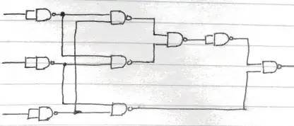

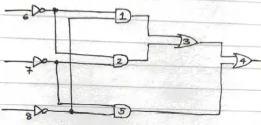

What is minimum number of two input NAND gates required to implement the function:
$f=\overline A \overline C+\overline A\overline B+\overline B \overline C$
I translated the function directly to the circuit as follows:
Then I converted this to NAND-only implementation as follows:
But when I checked the answer, it was saying lesser NAND gates. So I tried something different. I solved equation as follows:
$f=\overline{A}.\overline{C}+\overline{A}.\overline{B}+\overline{B}.\overline{C}$
$=\overline{\overline{\overline{A}.\overline{C}+\overline{A}.\overline{B}+\overline{B}.\overline{C}}}$
$=\overline{\overline{(\overline{A}.\overline{C})}.\overline{(\overline{A}.\overline{B})}.\overline{(\overline{B}.\overline{C})}}$
And realized that I will need seven NAND gates for following:

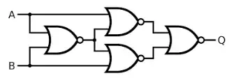

Another problem gave truth table of the function and asked to implement it with NOR gate. I prepared truth table for it and grouped zeroes as follows:
Knowing that I have to use NOR, I thought I should form product of sum equation of this and then take double negation to get NOR friendly equation. So, I formed equation for it as follows:
$f=(x+\overline y)(\overline x + y)$
$=\overline{\overline{(x+\overline y)(\overline x + y)}}$ (taking double complement)
$=\overline{\overline{(x+\overline y)}+\overline{(\overline x + y)}}$
Now this looks perfect NOR equation as thought and it requires five NORs. But when I checked the solution, I came to know that this is indeed ExNOR equation. The solution formed sum of product equation of K map:
$xy+\overline x \overline y$
and then implemented ExNOR with four NORs, something like this:
