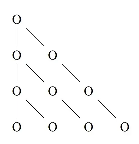

Your code has worst-case complexity $\Omega(n^{1.5})$. Consider a tree of height $h$ which is composed of a "backbone" of $h$ nodes, out of the $i$th of which (counting from the root) there is a path to the right ending at depth $h$. As an example, here is the case $h=4$: enter image description here
The height is computed along the entire backbone. The subtree rooted at the backbone node of depth $h-\ell+1$ has $\binom{\ell+1}{2}$ nodes (where $\ell=1$ corresponds to the backbone's leaf), and so computing the height of all subtrees along the backbone takes time proportional to $$ \sum_{\ell=1}^h \binom{\ell+1}{2} = \binom{h+2}{3} = \Theta(h^3). $$ In contrast, the tree contains $\binom{h+1}{2} = \Theta(h^2)$ nodes, so the running time in this case is $\Omega(n^{1.5})$ (in fact, it is $\Theta(n^{1.5})$ in this particular case).
