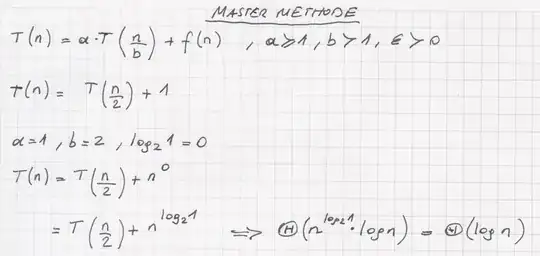

Luckily i had 2 day ago the algorithm exam and so i was able to solve your question :-) When solving recurrences try first to use the Master method, if you can't succeed than try other methods.
