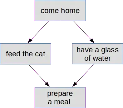

The simplest kind I've seen is just a bunch of boxes and arrows, like this:
What does this say? After we go home, do we both feed the cat and get a glass of water? Do we choose between them? Does it vary? We have no idea. This is not a specification, it's a sketch.

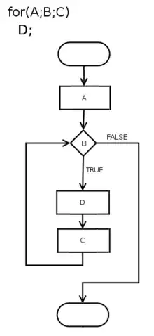

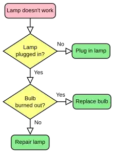

Then, of course, we have flowcharts. Flowcharts, like state machines, describe completely sequential processes. Starting in the initial state, each box in the flowchart takes us to the next state, until we reach the final state. The two examples in Wikipedia:
a flowchart with a loop a flowchart with two tests
The boxes are actions; the diamonds are tests, which pick the next step based on the test result. An imperative computer works this way, and so do many completely sequential algorithms executed by something other than a computer. Flowcharts can describe them, but they are of little help in reasoning about them: in designing them, redesigning them, or proving their correctness.
