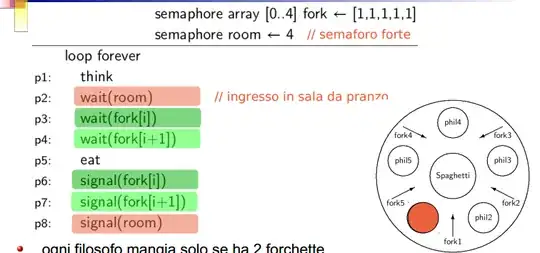

My prof introduced us an algorithm with semaphores that was used to solve the "dining philosophers" problem. The algo is ok, apart from that it limits concurrency.
What does mean that it "limits concurrency" and why this happens ?
