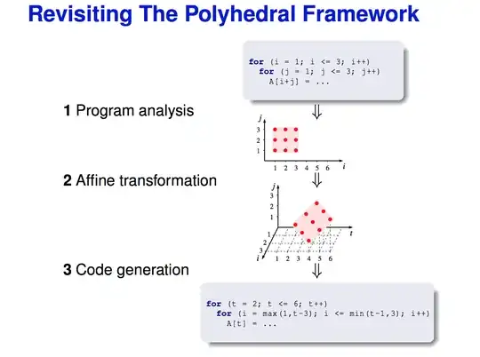

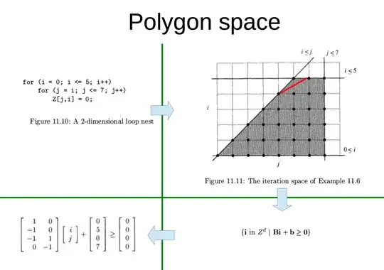

Specifically wondering what is going on in Figure 1 below. That is, where the polyhedra, lattice points, and affine transformations are, and how to represent/define them with mathematical notation. For instance, I haven't seen anything yet saying "a polyhedron from a loop is a tuple $p = (R, L, A)$ where $R$ is a set of loops, $L$ is a lattice and $A$ is a set of affine transformations, ...". Looking for the definitions of these 3 things and their relationship, as well as the relation between the loop variables and the what looks like is a matrix equation in the figure.
Figure (1) -^.
Figure (2) -^.
