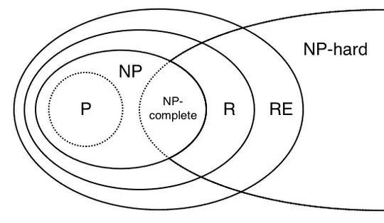

Overall: $NP\text{-complete} \subseteq NP \subsetneq R \subsetneq RE$
$NP\text{-complete} \subseteq NP$ by definition. It is unknown whether or not there are problems in $NP$ that are not $NP\text{-complete}$.
$NP \subseteq R$ as explained in Yuval Filmus's answer. The subset relation is strict ($NP \subsetneq R$) because we know there are problems in $R$ that are not in $NP$.
Since every $NP$ problem is in $R$ and as you pointed out $R$ is a subset of $RE$, $NP \subsetneq RE$ as well.
$NP\text{-hard}$ problems are at least as hard as the hardest problems in $NP$ but there's no upper limit on how hard they themselves can be. There are $NP\text{-hard}$ problems that are:
  • In $NP$ (take any $NP\text{-complete}$ problem as an example)
  • Not in $NP$ but in $R$ (see the second link)
  • Not in $NP$ and not $R$ (eg. the halting problem)
  • Not even in $RE$ (eg. the complement of the halting problem)
Putting this all together, you can visualize these classes in a Venn diagram like so:
Venn diagram containing P, NP, NP-hard, NPC, R, and RE
(If $P = NP$, then the innermost region would be a single circle representing $P = NP = NP\text{-complete}$)
