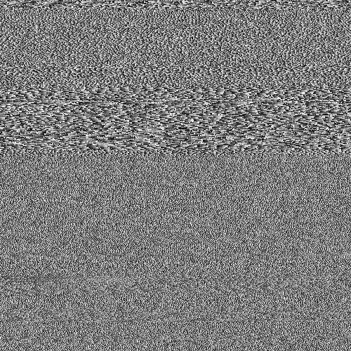

This Java fragment put into a loop:
      file.writeByte((byte) (System.nanoTime() & 0xff));
can create a data file which I've represented as an image:
nanoimage
You can see structure, but with a lot of randomness as well. The thing of interest is that this PNG file is 232KB in size, yet contains 250,000 grey scale pixels. The PNG compression level was maximum. That's only a compression ratio of 7%, ie. fairly non compressible. What's also interesting is that the file is unique. Every generation of this file is a slightly different pattern and has similar ~7% compressibility. I highlight this as it's critical to my argument. That's ~7bits/byte entropy. That will reduce of course upon use of a stronger compression algorithm. But not reduce to anything near 0 bits/byte. A better impression can be had by taking the above image and substituting its colour map for a random one:-

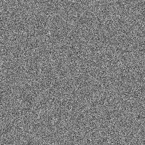

randomised nanoimage
Most of the structure (in the top half) disappears as it was just sequences of similar but marginally different values. Is this a true entropy source created by just executing a Java program on a multi taking operating system? Not a uniformly distributed random number generator, but the entropy source for one? An entropy source built of software running on physical hardware that just happens to be a PC.

Compression isn't an accurate test of randomness, and nor is looking at an image and saying "that looks random".
Randomness is tested by empirical methods. There are in fact suites of specially designed software/algorithms for testing randomness, for example TestU01 and the Diehard tests.
Furthermore, your image is in fact a 1D string of number mapped onto a space, and thus isn't a good representation of certain patterns that can appear.
If you were to examine your image pixel by pixel, you would most likely find many short patterns of increasing value before a sudden drop. If you were to create a graph with the x value being the sample number and the y value being the value obtained from the 'random' function, you would most likely find that your data in fact looks like a sawtooth wave:

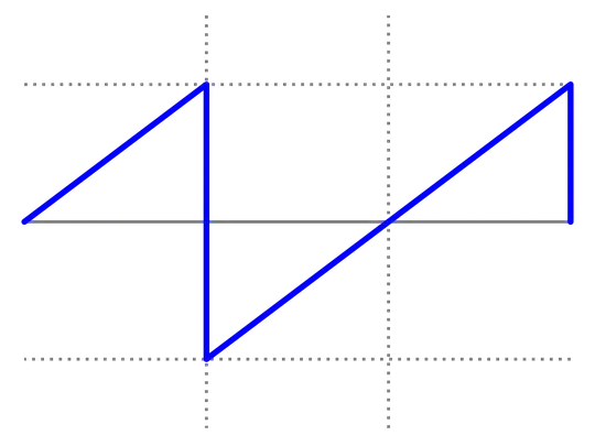

Sawtooth Wave
This is the pattern made by values that increase under modular arithmetic (which your computation is an example of: time increasing at a near constant rate, and the & 0xFF acting as mod 256).

A true random number generator would have no pattern, not even hidden in the background, which we could use to predict the next number given the sequence so far. In an ideal world, you could know everything there is to know in the physical universe, and about the system, nanosecond by nanosecond, and it still would be useless to try and predict the next number produced.
That's an ideal case - in practical terms we get there by mixing together many sources that are "not bad approximations" to random, or are truly random, or which mathematically mix things up enough that you can mathematically prove they get very close to unprediuctable and lack bias to any specific numbers or patterns.
  • "Good" sources are things similar to waiting for a radioactive decay process, or other quantum process that's inherently unpredictable. Output from a heat sensitive semiconductor. Random noise in a diode or other electrical material. Counting photons from the sun.
  • Mixed into this, we can also add some that we consider "not bad" which help as they don't have any connection to these: Waiting for the next mouseclick or network packet. Last bit of microtime on next file write. Output of a "known but mathematically pretty random" pseudorandom number generator function. Previous entropy from previous uses of random numbers.
The aim here, is to get a number which still cannot be predicted, whatever in the universe you know, and is statistically as likely to be this as that, with no mathematically detectable pattern, bias or predictability, and no correlation to an event that could be monitored and used for prediction. (Or if correlated with an event, then it's done in a way that makes the connection incredibly tenuous, such as "nanosecond digit only of time of last mouse click")
Deterministic numbers
Mathematicians can prove things about formulae and functions. So it's possible to prove that a function, when repeatedly called, doesn't give any bias or preference to any pattern, other than the simple pattern "these are the outputs of that function if repeatedly called".
So for example, if you pick a number say between 1 and 10 million, write it in binary, and "hash" it repeatedly, you'll get a pretty random looking sequence of digits. It's almost random - but it isn't actually random at all. You can predict given the algorithm and any state, what the next number will be.
We call it "pseudorandom" because it looks and seems to be mainly random, even if it isn't.
Here's a good example. Think about this sequence of 3 digit "random numbers": 983, 367, 336, 244, 065, 664, 308, 602, 139, 494, 639, 522, 473, 719, 070, 217. Let's say that I tell you I can generate a million numbers the same way. You can pass then to a statistician who will confirm (say) that they are distributed equally or whatever it may be. There's no obvious predictable patternb. They look pretty random, right? But now I tell you that they are actually
the 500th+ digit of Pi, grouped in 3s.
Suddenly, however random the
digits of Pi
may be, you can immediately predict that the next 2 numbers will be 986 and 094.
To be clear, I don't know exactly how random the
digits of Pi
are. It will have been studied and the answer well known. But the point is this: In principle, the same conclusion is true for any source that is produced following a deterministic process.
In between
In between the two, are a whole range of "things that look random and are often random to some degree". The more randomness and near randomness one can mix in, the less prone the output is to being able to have any pattern detected or any output predicted, mathematically.
Back to von Neumann and your question
As you can see, deterministic outputs might look random, but and might even, statistically, be randomly distributed. They might even use "secret" or fast-changing data that we have no realistic hope of knowing. But as long as it's deterministic, the numbers can still never truly be random. They can only be "close enough to random that we're happy to forget the difference".
That's the meaning of the quote you gave. A deterministic process just cannot give random numbers. It can only give numbers that seem to be, and behave quite like, random numbers.
We can now rephrase your question like this: "My (or any modern) computer's output can look and behave totally randomly, does that mean von Neumann's quote is now outdated and incorrect?"
The problem is still this: Even if your computer's output may look and behave randomly, it still may not be truly random. If it's only calculated deterministically, that means there is nothing that wasn't prediuctable cause-effect about gettinbg the next number (that's what "deterministic" means in this sense). We start with some existing data (known), we apply a known process (complex or messy or whatever), and we get what seems a new "random number" out. But it's not random, because the process was deterministic.
If you say that your method will include a true hardware random generator, to fix that (like a random number generated from radioactive decay or noise in a semiconductor), then your answer could now be random - but your method by definition is no longer deterministic, precisely because you can't predict the outputs (or effects) given the inputs/initial data (causes) any more.
Von Neumann wins both ways, almost by definition!
