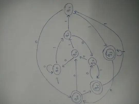

Check this out , it's not neat but it will get the work done. Correct me if i'm wrong in this DFA.
WizWarrior
