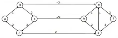

However I feel a bit different, especially after coming across problem asking to build shortest path tree from node $a$ in following graph:

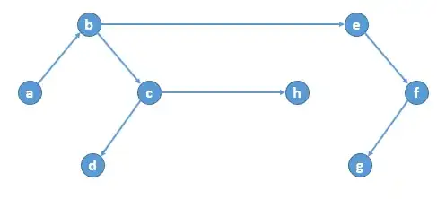

My shortest path tree after running Dijkstra came like this:
Then why texts say that Dijkstra need all non negative edge weights? I feel that it should be no -ve edge weight cycle reachable from source node. Am I correct with this? or am I missing something here?
