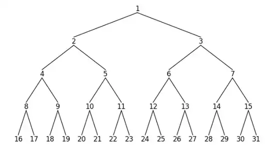

I really liked Yuval Filmus' answer, but wanted to try explaining it a bit differently after it had clicked for me.
The idea of implementing a full binary tree with an array is essentially just assigning indexes to each node. We'll use 1-indexing, as you'll soon see why, to show that the indexes sneakily encode the normal tree traversal you would use to reach any node.
Full binary tree with indexes labeled.
Normally we start from the root and then go downwards, traveling either left or right. Take the 26th node for example. To reach the 26th node, we take the following path:
root -> right -> left -> right -> left
Now note the binary representation of 26:
26 = 0b1_1010
The initial 1 denotes the root. Afterwards, 0 represents going left while 1 represents going right.
This means that in order to go left we want to append a 0 bit, and to go right we want to append a 1 bit.
In order to achieve this, we left shift one bit (which is multiplying by 2) and then add either 0 or 1.
  • tree[i].left = tree[2*i] to add a 0 bit.
  • tree[i].right = tree[2*i+1] to add a 1 bit.
To use 0-indexing, all we have to do is add 1 everywhere to simulate 1-indexing.

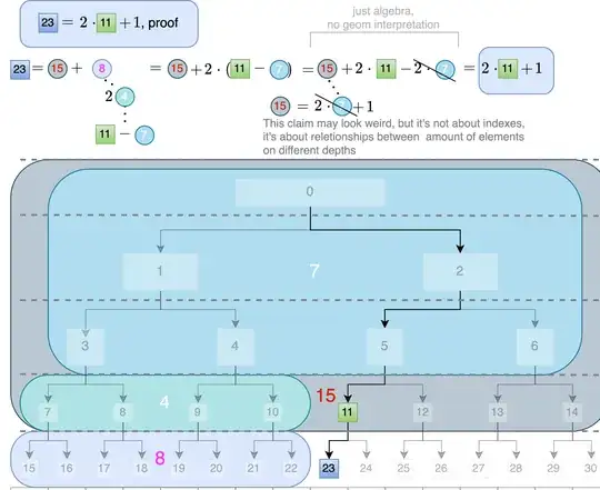

Well, first of all, i_right = i_left + 1. Always. It's obvious, so bellow I'm gonna show only proof of expression i_left_child = i_parent * 2 + 1.
In the explanation bellow there might be quite many definitions like: parent, child, index, position in current level, etc. So instead of greek/latin letters I decided to use the exact numbers from picture, but avoid any math operation on it, like it was a symbol. So it should work with all the numbers.
Slava
  • 101
Assume the tree is 1-indexed.
Let's say that the very first node of a level has an index n.
There are a total of n-1 nodes "behind" n-th node. This level in the tree can at max have n (total number of nodes below this level + 1) nodes. This means there can be n-1 more nodes at this level and anything more goes to the next level. Therefore, the last index of this level is 2n - 1 and the next level starts from 2n, 2n+1, 2n+2...
So node at index n will have 2n, 2n+1 as children, n+1 has 2n+2, 2n+3...
Let's start with something more obvious that is easier to accept. Notice how following the left path (1->2->4->8->16), the index is just doubling. This is because each level of a tree will have twice as many nodes as the previous (since each node has 2 children). So we can say for now that to get the left child index of the first index of any level, we just double it.
Let's focus on the row starting with 4. It's left child is just 2*4=8. What about 5? If we can accept that 4's left is 8, to get 5's left child we just need to add 2 (1 for the right child of 4, and 1 more to get to the left child of 5). Multiplication is just repeated addition, so another way to look at this is 2*4 + 2*1 = 2*(4+1) = 2*(5) = 10. Next 6, we can say the left child will be 2*4 + 2*1 + 2*1 this time since we need to skip the children of 4 and 5 to get to the children of 6. This simplifies like 2*4 + 2*1 + 2*1 = 2*(4+1+1) = 2*(6) = 12. So we can conclude that the left child of any number is just 2 times it, this is not just a fact unique to the first index. The right child will simply be 1 more than the left or 2*current+1.
This was all 1 based though, going to 0 based the left path will be like (0->1->3->7->15), just subtracting 1 from path before. Something to notice here is that we are not doubling anymore, we are doubling AND adding 1, or 2*current+1. Instead of 4 and 5 this time, we will be considering 3 and 4 as the indexes decreased by 1. 3's left will be 2*3+1. Add 2 to that (to skip 3's children) to get 4's left which is 2*3+1 + 2*1 = 2*(3+1) + 1 = 2*(4) + 1. Here we have proven both 3's and 4's left children can be found by just multiplying by 2 and adding 1. The same applies to any number. And the right child is just adding 1 to that. We have now proven why leftchild=2n+1 and rightchild=2n+2.
Nick
