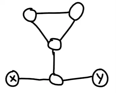

If there exist a path from source $x$ to some cycle it doesn't always contradict the existence of a single simple path. Take a look at the following example: enter image description here
Here there is a cycle that can be reached from $x$ and $y$. This problem can be solved in $O(|V| + |E|)$.
You can run BFS to find shortest distance from $x$ to every vertex on the graph and the same from $y$. One node belong to the shortest path from $x$ to $y$ if and only if $$distance(x,u) + distance(u,y) = distance(x,y)$$ Now, to check if there is a single path, check that valid nodes in shortest path at every distance occurs at most once. This is, if there are at least two nodes that belong to a shortest path from $x$ to $y$ with the same distance to $x$ then, there are at least two shortest path, otherwise it is unique. You can do all post-processing in $O(|V|)$.
