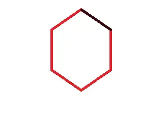

Regarding DFS the answer is no. Here there is a counter example.
The red arcs represent the DFS tree starting from the topmost node. This tree depth is 5 while the diameter is 3.
