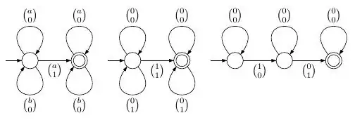

Conversely, we can represent the meaning of MSO formulas by finite state automata inductively, following the construction of the automata. To do this we augment the alphabet of the automaton, by adding components that indicate the value of the free position variables $i$ and set variables $X$. If we read a string along the automaton we find exactly a single $1$ to indicate a certain postion $i$, and the positions in a set $X$ are marked likewise.
The basic formulas are $R_a(i)$ for "position $i$ has symbol $a$", $i\in X$ for "$i$ is an element of $X$" and $i<j$ for "position $i$ is before position $j$". These formulas can be represented by the following simple finite state automata (over the augmented alphabet suited for the formula):
basic automata
More complicated formulas are constructed using the Boolean connectives $\lor, \lnot$ and the existential quantifiers $\exists i, \exists X$. The intended meaning of these operators are easily translated to languages as the language operators union $\cup$, complement ${}^c$ and projection, which is the operation that removes the corresponding component from the augmented alphabet. For union we have to pay some attention to the augmented alphabets in case the two parts of the formula do not agree on the set of free variables. Projection is simple, but it will change a deterministic automaton into a nondeterministic one.
