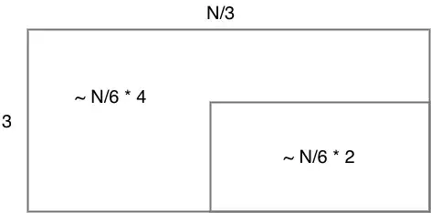

For $\frac{n}{3}$ size subarrays we will end up with an area diagram like this:
div3
It is clear that in the worst case we will have to recurse on roughly $\frac{4 n}{6}$ elements in the array. This will give us a recurrence relation: $$\begin{align} T(n) & = T\left(\frac{n}{3}\right) + T\left(\frac{4n}{6}\right) + cn\\ & = T\left(\frac{n}{3}\right) + T\left(\frac{2n}{3}\right) + cn \end{align}$$ This actually turns out to be on the order of $O(n \log n)$. I won't go through an explicit proof of this recurrence because I'm sure it's been done before. If you wish to prove it to yourself, you can use a similar approach to this, or use the recursion tree method, or use the Akra-Bazzi method. So this subarray size won't work because we now have non-linear time complexity.

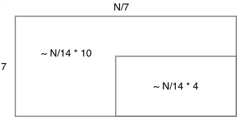

For $\frac{n}{7}$ size subarrays we will end up with an area diagram like this:
div7
We similarly get a worst-case recurrence of the following:
$$T(n) = T\left(\frac{n}{7}\right) + T\left(\frac{10n}{14}\right) + cn$$
This is also linear! Again, you can use the method I described above to prove this.
