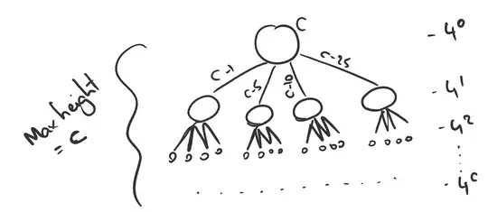

Now, looking at the coin make change problem. If the coin denominations are [1, 5, 10, 25] and the input number to make change for is 'C', the recurrence tree should look something like this: enter image description here
In this case, the tree can have a maximum height of 'C' and the number of branches per step is 4 (The number of coin denominations we are given. Let's call this 'n'). With that being the case, shouldn't the time complexity be O(n^C). I read everywhere that the time complexity is O(C^n). Can someone please explain?

As for the coin change problem it is not $O(n^C)$. $n^C$ is a polynomial, while the number of branches in the tree grows exponentially. In other words, given $n$ number of coin denominations and constant $C$, each node has no more than $C$ children, and so the number of branches/leaves is at most $C\times C\times \dots C$ ($n$ times). In fact the actual number of branches is less than $C^n$, but is definitely bounded from above by $C^n$, and so is $O(C^n)$ (recall that big-O denotes the upper bound of a function).
