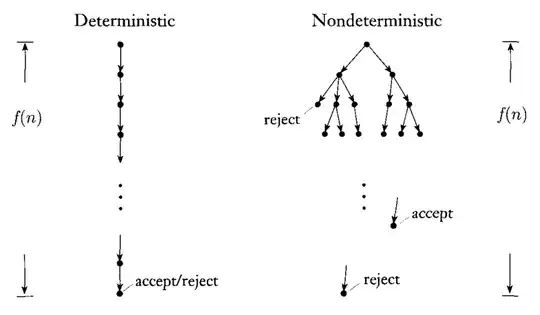

Acceptance of input string in NTM
let me add more about deterministic and non-deterministic Turing machines. Let us consider that for some language $L$, we design a deterministic and non-deterministic Turing machine respectively. On some input $x$, there is going to be only one path of configurations in the case of deterministic Turing machine, i.e $c_0 \longrightarrow c_1 \longrightarrow \cdots \longrightarrow c_k$ (where each $c_i$ represents a configuration at $i$th step) . Now on the basis of configuration $c_k$, we can easily accept and reject the input string $x$.
See the image below for better understanding : enter image description here
In the case of NTM, we need to be careful, because it may happen that on some configuration paths, we get into rejecting state. So for non-deterministic Turing machines, we say a string is accepted if at least one of the configuration path leads to accepting state. We will reject the input string if all configuration paths lead to rejecting state.
For example, consider the configuration tree given above for non-deterministic Turing machine on say some input string $x$, In this case we will accept the input string because there is an one accepting path.

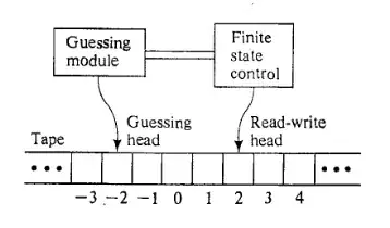

Augmentation with a guessing module.
I found this model in "Computers and Intractability" by M.R. Garey and D.S. Johnson.
The NDTM has exactly the same structure as a DTM, except that it is augmented with a guessing module having it own write-only head. The guessing module provides the means for writing down the "guess" and is used solely for this purpose.
How it works.
The first stage is the guessing stage. Initially, the input string $x$ is written in tape squares $1$ through $|x|$ (while all other squares are blank), the read-write head is scanning square $1$, the write-only head is scanning square $-1$, and the finite state control is "inactive". The guessing module then directs the write-only head, one step at a time, either to write some symbol from the tape alphabet $\Gamma$ in the tape square being scanned and move one square to the left, or to stop, at which point the guessing module becomes inactive and the finite state control is activated in state $q_0$. The choice of whether to remain active, and, if so, which symbol from $\Gamma$ to write, is made by the guessing module in a totally arbitrary manner. Thus the guessing module can write any string from $\Gamma^*$ before it halts and, indeed, need never halt.
The "checking" stage begins when the finite state control is activated in state $q_0$. From this point on, the computation proceeds solely under the direction of the NDTM program according to exactly the same rules as for a DTM. The guessing module and its write-only head are no longer involved, having fulfilled their role by writing the guessed string on the tape. Of course, the guessed string can (and usually will) be examined during the checking stage. The computation ceases when and if the finite state state control enters one of two halts states (either $q_Y$ or $q_N$) and is said to be accepting computation if it halts in state $q_Y$. All other computations, halting or not, are classed together simply as non-accepting computations.
Notice that any NDTM program $M$ will have an infinite number of possible computations for a given input string $x$, one for each possible guessed string from $\Gamma^*$. We say that the NDTM program $M$ accepts $x$ if at least one of these is an accepting computation.
The time required by an NDTM program $M$ to accept the string $x\in L_M$ is defined to be the minimum, over all accepting computations of $M$ for $x$ , of the number of steps occurring in the guessing and checking stages up until the halt state $q_Y$ is entered.
The only point deserving special special mention is that, wheres we usually envision a nondeterministic algorithm as guessing a structure $S$ that in some way depends on the given [problem] instance $I$, the guessing module of an NDTM entirely disregards the given input. However, since every string from $\Gamma^*$ is a possible guess, we can always design our NDTM program so that the checking stage begins by checking whether ot not the guessed string corresponds (under the implicit interpretation our program places on strings) to an appropriate guess for the given input. If not, the program can immediately enter the halt state $q_N$.
