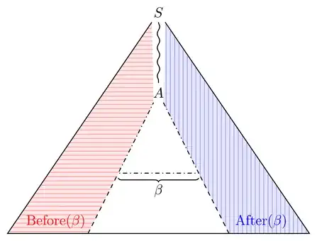

Let us get a feeling for $\operatorname{Before}(\beta)$ and $\operatorname{After}(\beta)$ first. Consider a derivation tree which contains $\beta$; "contains" here means that you can cut away subtrees so that $\beta$ is a subword of the tree's front. Then, the before (after) set are all potential fronts of the tree's part left (right) of $\beta$:
tree with before and after sets
[source]
So we have to build a grammar for the horizontally lined (vertically lined) part of the tree. That seems easy enough as we already have a grammar for the whole tree; we just have to make sure all sentential forms are words (change the alphabets), filter away those that do not contain $\beta$ (that is a regular property as $\beta$ is fixed) and cut away everything after (before) $\beta$, including $\beta$. This cutting should also be possible.
