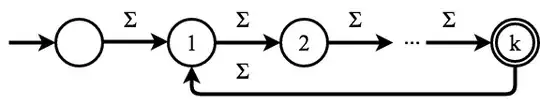

I assume that you wish to demonstrate that $L = \{ w \in \Sigma^* \colon |w| = k, 2k, ...\}$ for some $k > 0$ is a regular language (correct me if I am wrong).
If that is the case, all you need to do is to construct a DFA $M$ such that $L(M) = L$:
DFA
