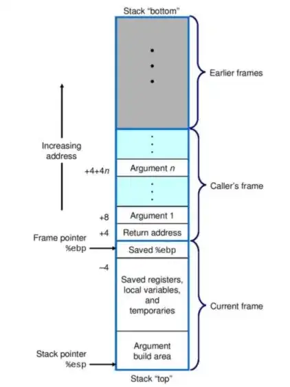

To provide a concrete example of how a compiler manages the stack and how values on the stack are accessed, we can look at visual depictions, plus code generated by GCC in a Linux environment with i386 as the target architecture.
1. Stack frames
As you know, the stack is a location in the address space of a running process that is used by functions, or procedures, in the sense that space is allocated on the stack for variables declared locally, as well as arguments passed to the function (space for variables declared outside any function (i.e. global variables) is allocated in a different region in virtual memory). Space allocated for all of a function's data is referred to a stack frame. Here is a visual depiction of multiple stack frames (from Computer Systems: A Programmer's Perspective):
CSAPP stack frame
2. Stack frame management and variable location
In order for values written to the stack within a particular stack frame to be managed by the compiler and read by the program, there must be some method for calculating the positions of these values and retrieving their memory address. The registers in the CPU referred to as the stack pointer and the base pointer help with this.
The base pointer, ebp by convention, contains the memory address of the bottom, or base, of the stack. The positions of all of the values within the stack frame can be calculated using the address in the base pointer as a reference. This is depicted in the picture above: %ebp + 4 is the memory address stored in the base pointer plus 4, for example.

What we observe is that variables x, y and z are located at addresses %ebp - 12, %ebp -8 and %ebp - 4, respectively. In other words, the locations of the variables within the stack frame for main() are calculated using the memory address saved in the CPU register %ebp.
