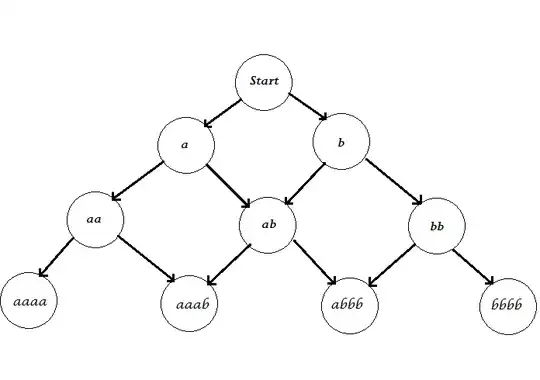

I have a graph which looks something like below Search
I am searching for a given string s going down such that at every node it makes a decision (either to visit the left node or right). The code goes something like this.
String s=input;
Node CurrentNode=start;
int rightSubstringIndex=-1;
int leftSubstringIndex=-1;
while(true){
    if(CurrentNode.getValue()==s){
        return 1;//indicating that the string was found in the graph
    if(CurrentNode.right==null){//there won't be a node with only one child so either both child nodes are there or there is no child
        return 0;//indicating that the string was not found in the graph
    rightSubstringIndex=findSubStringIndex(CurrentNode.right.getValue(),s);
    leftSubstringIndex=findSubStringIndex(CurrentNode.left.getValue(),s);
    if(rightSubstringIndex<leftSubstringIndex){
        CurrentNode=CurrentNode.right;//go towards the right node
    else if(leftSubstringIndex<rightSubstringIndex){
        CurrentNode=CurrentNode.left;//go towards the left node
    else{//i.e when rightSubstringIndex==1000 && leftSubstringIndex==1000
        return 0://indicating that the string was not found in the graph
findSubstringIndex(a,b) returns the index in the string array b where the substring a starts . Returns 1000 if the the substring a doesn't occur in b(assuming that there will not be a string having length greater than 1000 characters).The time complexity of function findSubstring(a,b) is assumed to be $O(1)$.
I am interested in finding out the time complexity of the above described algorithm.I know that if it was a binary tree and I had to look up for the string using a similar strategy the complexity will be $O(logN)$. I don't know how to think of complexity in terms of number of nodes in this scenario.

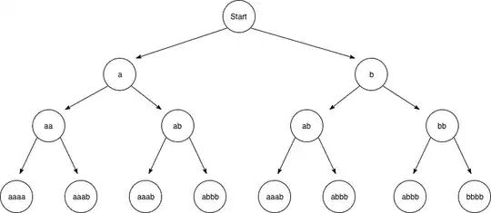

This answer is under the assumption that findSubstring() is $O(1)$, which it realistically is not. Notice that at each iteration, when you make a step down to the next level in the graph, the problem size is being reduced by a factor of 2. That is, the amount of possible solutions is being reduced by a factor of 2. Specifically this is because the size of the strings duplicate at each layer down into the graph. So at any rate, if you have a string of length $n$, it will take $\log n$ steps to reach a solution using this algorithm. Furthermore, the string length must be a power of 2. This is a bit easier to visualize if you split your graph into its equivalent binary tree:
binary tree rep
This is a valid representation because each time you go left or right, you are cutting yourself off from impossible solutions, and that is exactly what happens in binary trees.
