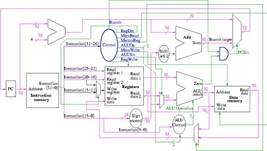

Actually, and in order to obtain the full image of it, I think it would be quite helpful to see with your own eyes the datapath of an actual CPU, for example MIPS: enter image description here
As you may see, there is actually a second output from the ALU, which is a signal called Zero. It exists in order to perform fast branch operations, after determining whether the two operands of the comparison are equal to zero or not, as most comparisons within a program are about branches. Therefore, when you create a branch possibility in your code like:
if(a < b) {...}
This is translated into machine code, in mips for example: blt s0,s1,If $~\Rightarrow$ if a < b execute the instructions in the brackets, else continue with the execution outside the if{}. Specifically this instruction is a pseudo-instruction, which means that is translated into two other (simple) MIPS instructions $~\Rightarrow$
slt at,s0,s1 and then bne at,zero,If (slt: Set Less Than & bne: Branch on Not Equal).
Notice that signal zero is one of the inputs of the AND gate that determines where the Program Counter (PC) will take its value from: Assuming that Branch signal is '1', as we have a branch operation
  • Zero = 0 $\Rightarrow$ The result of the subtraction was not equal to zero, so the Multiplexer will choose the address from Branch target and the execution will continue from the instruction that the branch leads.
  • Zero = 1 $\Rightarrow$ The result was 0 (a = b) and so the MUX chooses the address from the adder where is calculated the address of the next instruction in normal execution (serial). No jump is executed as the condition (a < b) is invalid.
Hope I helped you see "under the bonnet". Feel free to ask for further analysis on this matter. Many things we take for granted, CPUs do them in a very fascinating way!
