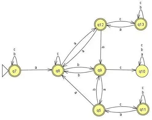

So I have been trying to create a Deterministic Finite Automaton(DFA) in Jflap that accepts all strings from the alphabet {a, b, c} except those that contain the substring "abc". However i keep running into issues where certain strings that should be allowed aren't, such as "acbc". Do you have any tips or tricks that can be used to get around these kind of issues? My DFA

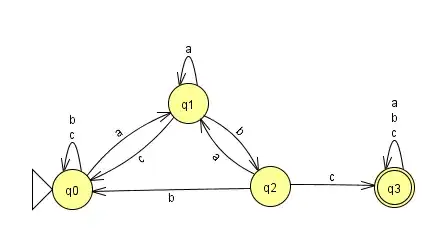

DFA that accepts any string that contains substring "abc" below

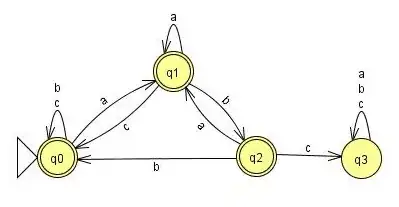

This is the inverted DFA of Image 2 which should accept all string combinations of the language{a,b,c} that do not contain the substring "abc"
Final Automaton
