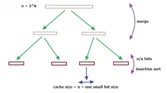

Basic Idea
  • For small values of n insertion sort runs faster than merge sort . Hence insertion sort can be used to Optimize merge sort
  • Basic idea is apply insertion sort on sublists obtained in merge sort and merge the sorted (using insertion sort) lists
Coming to Question
Base Condition
If each word is 4-byte long, then a 128-byte cache contains 32 words. Therefore, if the problem size is 32 or less, the instance will be immediately solved by Insertion Sort, otherwise it will be split in two sub-problems with the same size, which will then have to be merged
Time Complexity
Total Complexity = Complexity Insertion Sort + Complexity of Merge Sort
We have $n$ elements . We are dividing it to $\frac{n}{x}$ sublist each contain x elements each
Complexity Of Merge Sort
  • Total work done by merge sort in copying $n$ elements from each level to upper level is $O(n)$
  • Number of levels = number of sublists or small problem = $O(\log \frac{n}{x})$
  • Complexity of Merge sort : $O( n \log \frac{n}{x} )$
Complexity Of Insertion Sort
  • We are sorting $ \frac{n}{x} $ lists each of $x$ elements using insertion sort so complexity contributed by insertion sort is $\frac{n}{x} $ INSERTION ${x}$
Total Complexity = $\Theta ( \frac{n}{x} \ \text{INSERTION} \ (x) + n \log \frac{n}{x} )$
Best Case
  • is when Insertion sort perform in best case with $O(n)$ ie $\text{INSERTION} \ (x) = x$
  • Best Case Complexity=Total Complexity = $\Theta ( n + n \log \frac{n}{x} )$
Worst Case
  • is when Insertion sort perform in best case with $O(n^{2})$ ie $\text{INSERTION} \ (x) = x^{2}$
  • Best Case Complexity=Total Complexity = $\Theta ( nx + n \log \frac{n}{x} )$
More Information : Gate Overflow - Sorting Algorithm
