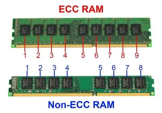

That text is extremely poorly worded. He is almost certainly talking about ECC (error-correcting code) RAM.
ECC ram will commonly store 8-bits worth of information using 9-bits. The extra bit-per-byte is used to store error correction codes.
(In both cases, every byte is spread across every chip. Image courtesy of Puget Systems)
This is all completely invisible to users of the hardware. In both cases, software using this RAM sees 8 bits per byte.
