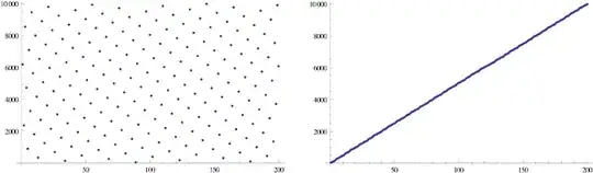

You can use Fibonacci hashing, namely
$\qquad h_F(k) = k \cdot \frac{\sqrt{5} - 1}{2} - \left\lfloor k \cdot \frac{\sqrt{5} - 1}{2} \right\rfloor$.
For $k=1,\dots,n$ you get $n$ pairwise-distinct numbers (about) evenly spread in $[0,1]$. By scaling to $[1..M]$ and rounding (down), you get about evenly spread numbers in that interval.
For example, these are $h_F(1), \dots, h_F(200)$ scaled to $[0..10000]$ (left original sequence, right sorted):
This is an instance of what Knuth calls multiplicative hashing. For $w$ the computer's word size, $A$ some integer relatively prime to $w$ and $M$ the number of addresses needed, we use
$\qquad h(k) = \left\lfloor M \left( \bigl( k \cdot \frac{A}{w}\bigr) \mod 1 \right) \right\rfloor$
as hashing function. The above follows with $A/w = \phi^{-1} = \frac{\sqrt{5}-1}{2}$ (make sure you can compute it with a sufficient precision). While this also works with any other irrational number besides $\phi^{-1}$, it is one of only two numbers that lead to the "most uniformly distributed" numbers.
Find more in The Art of Computer Programming, Volume 3 by Donald Knuth (chapter 6.4 from page 513 in the second edition). In particular you'll find why the resulting numbers are pairwise distinct (at least if $n \ll M$) and how to compute the inverse function if you use natural $A$ and $w$ instead of $\phi^{-1}$.
