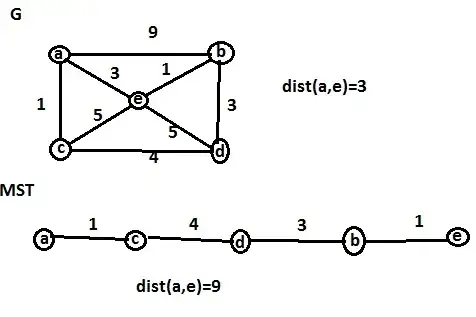

As my title points out, I don't understand how do you show that, in general, the diameter of a MST (minimal spanning tree) can be bigger than the diameter of G, by the factor $\Omega(n)$. $(n:= |V|, G =(V,E)) $.
And I don't understand, how big is $\Omega(n)$ and why $\Omega$?
I made a example where the distance of two nodes in $G$ is smaller than the distance of the two nodes in the MST.
diamter of G and the MST of G
Is it correct to write,
  • $D_{MST} = D_{G} \cdot \Omega(n)$ ?
  • $\Omega(n) = D_{MST}/D_{G}$ ?
$D_{G} =$ diameter of graph $G$ and $D_{MST} =$ diameter of MST.

You say that you don't understand how to show that the diameter of a MST can be $\Omega(n)$ larger than the diameter of the underlying graph.
However, it seems that what you don't understand is what it means that the diameter of a MST can be $\Omega(n)$ larger than the diameter of the underlying graph.
It is impossible to prove a theorem if you don't understand its statement.
Here is what you are asked to do. Given a weighted graph $G$, we will use the following notation:
  • $n(G)$ is the number of vertices in $G$.
  • $D(G)$ is the diameter of $G$.
  • $D_{MST}(G)$ is the minimum diameter of a minimum spanning tree of $G$.
Give a sequence of graphs $G_i$ such that $n(G_i) \to \infty$ and $D_{MST}(G) = \Omega(n(G)) \cdot D(G)$.
It seems that you are not familiar with the notation $\Omega(\cdot)$. It is the counterpart of big O, and described in the answers to this question.
Unpacking the big $\Omega$ notation, we can rephrase the question:
Give a sequence of graphs $G_i$ such that $n(G_i) \to \infty$ and there exists a constant $C>0$ such that $D_{MST}(G_i) \geq C n(G_i) D(G_i)$.
The question is somewhat ambiguous – it's not clear if you need to provide an example for every $n$ or just for infinitely many $n$. I assumed the latter, but in fact in your case there is a sequence $G_i$ with $n(G_i) = i$, so you can try proving this stronger statement instead.
