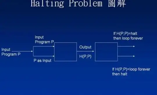

I'm having trouble understanding the proof of the undecidability of the Halting Problem.
http://computing.guide/wp-content/uploads/2014/12/HaltingProblem1.jpg
If $H(a,b)$ returns whether or not the program $a$ halts on input $b$, why do we have to pass the code of $P$ for both $a$ and $b$?
Why can't we feed $H()$ with $P$ and some arbitrary input, say, $x$?

Ignore the picture for a moment; we'll get to it shortly. The program $H(a, b)$ is supposed to be a halt tester: when we give $H$ an input of a program $a$ (think of $a$ as the listing of a program) and anything at all for $b$, $H(a, b)$ acts as follows
  1. If the program represented by $a$ halts when given $b$ as input, $H(a, b)$ will answer "yes". On the other hand, if the program described by $a$ runs forever when given input $b$ then $H(a, b)$ will answer "no".
  2. Importantly, program $H$ will always halt and give the correct answer for any pairs $(a, b)$.
The argument that $H$ is impossible to build relies on the action of a particular "perverse" program, $P$, one which uses $H$ as a subroutine. $P$ takes as its input a listing of any program, $x$, and does the following:

Now return to the picture. What happens if $P$ is given its own description as input? The picture describes just that scenario: Let $p$ be the description of program $P$, then, substituting into the highlighted part above, we'll have
$P(p)$ will halt if and only if the program $P(p)$ will run forever.
Clearly, this paradoxical behavior is impossible, so we're forced to the conclusion that the subroutine $H$ cannot be a halt tester, since it fails in the one case, where it's given $(p, p)$ as input. There might be other cases where $H$ works as it should, but since $H$ fails in at least one situation, it cannot be a complete halt tester, as required.

The proof aims to find a contradiction. You have to understand what the contradiction derived is, in order to understand why $P$ is used as an input to itself. The contradiction is, informally: if we have a machine H(a, b) that decides "a accepts b", then we can construct a machine that accepts machines that do not accept themselves. (Read that a few times until you get it.) The machine shown in the picture – let's call it $M$ – $M(P) = $ does $P$ not accept $\langle P \rangle$?
The contradiction happens when you ask: does $M$ accept $\langle M \rangle$? Try to work out the two options to see how there is a contradiction.
$M$ accepts $\langle M \rangle$ if and only if $M$ does not accept $\langle M \rangle$; this is clearly a contradiction.
