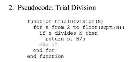

Pseudocode for trial division:
I understand that the time complexity of the algorithm is O(sqrt(N)). However, can someone explain how the person in the link below came up with O(e^(n/2)). In other words, what's the mathematical relationship between N and n? Thanks.

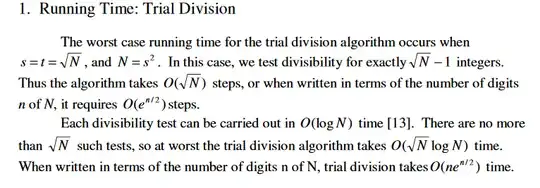

Time complexity explanation:

The integer $N$ takes $\log_2 N$ bits to write down. Set $n = \log_2 N$. Then $N = 2^n$, so $\sqrt{N} = 2^{n/2}$.
I'd guess they are using the natural logarithm (to base $e$), which is where they get $e$ instead of $2$. That's a bit odd but I suppose it is valid.
