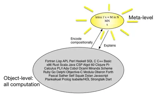

Another way of looking at denotational semantics is that there are many programming languages and they all look kind-of similar, so maybe we can find a simple, yet universal meta-language, and map all programming languages in a compositional manner to that meta-language. In the 1960s, it was thought that some typed $\lambda$-calculus is that meta-language. A picture might say more than 1000 words:
What is the advantage of this approach? Maybe it makes sense to look at it from an economic POV. If we want to prove something interesting about a class of object program we have two options.
  • Prove it directly on the object level.
  • Prove that the translation to the meta-level (and back) 'preserves' the property, and then prove it for the meta-level, and then push the result back to the object level.
The combined cost of the latter is probably higher than the cost of the former, but the cost of proving the translation can be amortised over all future uses, while the cost proving the property for the meta-level is much smaller than that of the proof on the object level.
The original order-theoretic approach to denotational semantics has so far not lived up to this promise, because complicated language features such as object orientation, concurrency and distributed computation have not yet been given precise order-theoretic semantics. By "precise" I mean semantics that matches the natural operational semantics of such languages.
