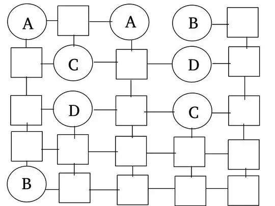

Here is a pictoral example of a simple input:
Input graph
In this example, $n = 5$ and $k = 4$. Notice that on the top row of nodes, the "adjacent" A and B nodes are not really adjacent (they have no connecting edge). This is what I was trying to explain in my 4th point. Also notice the "marked" nodes I was referring to are circles and are labeled with letters, marking them.

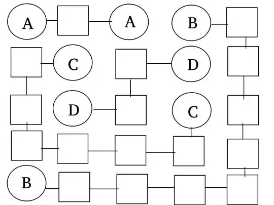

Here is a pictoral representation of the solution to the example input:
Output graph
