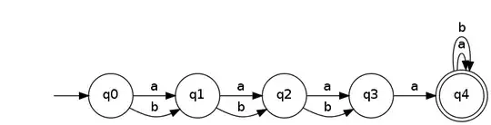

Thus let $L_n = (a|b)^n a (a|b)^*$. It is recognized by a simple DFA with $n+2$ states.

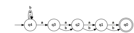

Reversing it yields an NFA that recognizes $L_n^R = (a|b)^* a(a|b)^n$.
nfa
The minimal DFA that recognizes $L_n^R$ has at least $2^{n+1}$ states. This is because all the words of length $2^{n+1}$ must reach distinct states in the DFA. (In other words, they belong to distinct Myhill-Nerode equivalence classes.) To prove this, take two distinct words $u,v \in \mathscr{A}^{n+1}$ and let $k$ be a position where they differ ($u_k \ne v_k$). Without loss of generality, let's assume $u_k = a$ and $v_k = b$. Then $u b^k \in L_n^R$ and $v b^k \notin L_n^R$ ($b^k$ is a distinguishing extension for $u$ and $v$). If $u$ and $v$ led to the same state in a DFA recognizing $L_n^R$ then so would $u b^k$ and $v b^k$, which is impossible since one leads to an accepting state and the other one doesn't.
