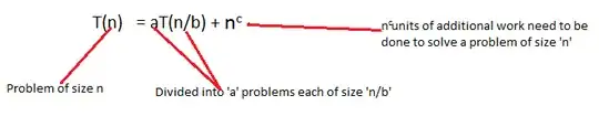

It is better if you go through its proof and understand it.But if you want to remember then you should make note of these few points:
It is applicable to recurrences of following form:
Then calculate $$ x=\ Log_ba $$
  1. if c < x then $$ T(n)=\theta(n^x) $$
  2. if c = x then $$ T(n)=\theta(n^cLog n) $$
  3. if c > x then $$ T(n)=\theta(n^c) $$
Also go through Master's Theorem eligibility for situations having limitations with this theorem.
I hope it makes sense to you.....
