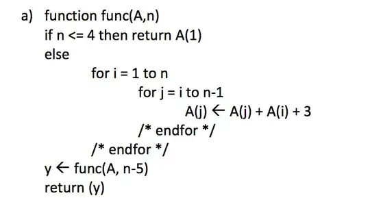

The following is pseudo code and I need to turn it into a a recurrence relation that would possibly have either an arithmetic, geometric or harmonic series.
Pseudo code is below.
I have so far T(n) = T(n-5) + c

T(n) = T(n-5) + c
Solution by substitution:
$T(n) = T(n-5) + c..................................(1)$
therefore, $T(n-5) = T(n-10) + c ....................(2)$
Substituting $(2)$ in $(1)$, gives
$T(n) = T(n-10) + c + c .............................(3)$
Similarly, $T(n-10) = T(n-15) + c ....................(4)$
Substituting $(4)$ in $(3)$, gives
$T(n) = T(n-15) + c + c + c .........................(5)$
and so on.
Finally, $T(n) = T(k) + \frac{cn}{5}$ where $k<=4$
then $T(n) = 1 + \frac{cn}{5}$
therefore $f(n)=O(n)$ as $\frac{c}{5}$ is a constant.
