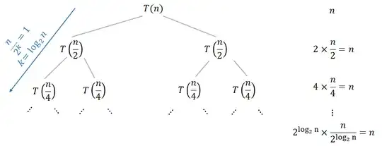

I was solving recurrence relations. The first recurrence relation was
$T(n)=2T(n/2)+n$
The solution of this one can be found by Master Theorem or the recurrence tree method. The recurrence tree would be something like this:
![enter image description here
The solution would be:
$T(n)=\underbrace{n+n+n+...+n}_{\log_2{n}=k \text{ times}}=\Theta(n \log{n})$
Next I faced following problem:
$T(n)=2T(n/2)+\log{n}$
My book shows that by the master theorem or even by some substitution approach, this recurrence has the solution $\Theta(n)$. It has same structure as above tree with the only difference that at each call it performs $\log{n}$ work. However I am not able to use same above approach to this problem.

The non-recursive term of the recurrence relation is the work to merge solutions of subproblems. The level $k$ of your (binary) recurrence tree contains $2^k$ subproblems with size $\frac {n}{2^k}$, so you need at first to find the total work on the level $k$ and then to summarize this work over all the tree levels.
For example, if the work is constant $C$, then the total work on the level $k$ will be $2^k \cdot C$, and the total time $T(n)$ will be given by the following sum:
$$T(n) = \sum_{k=1}^{\log_2{n}}2^k C = C(2^{\log_2{n}+1}-2) = \Theta(n)$$
However, if the work logarithmically grows with the problem size you'll need to accurately compute the solution. The series would be like the following:
$$T(n)=\log_2{n}+\underbrace{2\log_2(\frac {n} {2})+4\log_2(\frac {n} {4})+8\log_2(\frac {n} {8}) + ....}_{\log_2{n} \text{ times}}$$
It'll be a quite complex sum:
$$T(n)=\log_2{n}+\sum_{k=1}^{\log_2{n}}2^k \log_2(\frac {n} {2^k})$$
I'll temporarily denote $m=\log_2{n}$ and simplify the summation above:
$$\sum_{k=1}^{m}2^k \log_2(\frac {n} {2^k})=\\=\sum_{k=1}^{m}2^k(\log_2{n}-k)=\\=\log_2{n}\sum_{k=1}^{m}2^k-\sum_{k=1}^{m}k2^k=\\=\log_2{n}(2^{m+1}-2)-(m2^{m+1}-2^{m+1}+2)$$
Here I used a formula for the $\sum_{k=1}^{m}k2^k$ sum from the Wolfram|Alpha online symbolic algebra calculator. Then we need to replace $m$ back by $\log_2{n}$:
$$T(n)=\log_2{n}+2n\log_2{n}-2\log_2{n}-2n\log_2{n}+2n-2$$ $$=2n-\log_2{n}-2=\Theta(n)$$
Q.E.D.
