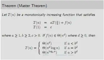

It's probably easier solving this using the Master Theorem.
T(n) = 6T(n/6) + 2n + 3
So in this case A=6, B=6, and D=1 because f(n) = 2n + 3 and 2n^1 + 3 = 2n + 3
We of course assume the base case is a constant such that T(1) = C
So we can easily see that the answer for this is T ( n ) = Θ ( n log n ) , since A is equal to B to the power of D.
We can see that is true just by plugging in the values
= A = B^D
= 6 = 6^1
= 2 > 1 (which is always true)
This guy on YouTube has a very nice video explaining how to solve recurrences using the Master theorem, I will leave the link here.
