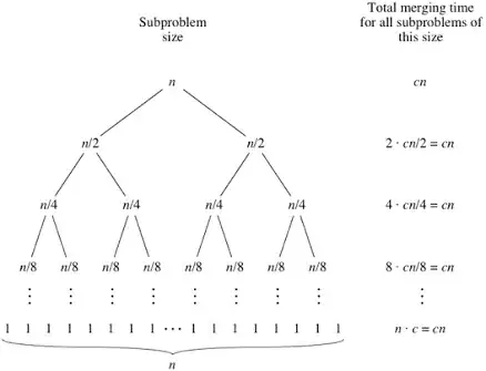

Draw a binary tree with the root node corresponding to the array $A[1,N]$ and with each node having two children corresponding to its left and right halves and recursively draw the structure for each child till we have arrays of size $1$. Denote each node by the size of the array that it corresponds to. We will get something that looks like this
(Taken from Khan Academy) Merge Sort Recursion Tree
This is the recursion tree for merge sort.
The computation time spent by the algorithm on each of these nodes is simply two times the size of the array the node corresponds to. Therefore the total running time $S$ of mergesort is just the sum of all the sizes of the arrays that each node in the tree corresponds to i.e. $$S = 2 \sum_{i=0}^k 2^i\frac{n}{2^i}$$
(How did we get this sum? There are $2^i$ nodes of size $\frac{n}{2^i}$ in the tree and it takes $2k$ time to finish computation on an array of size $k$)
Observe that when $i=k$, $\frac{n}{2^k} = 1 \implies n = 2^k \implies k = \lceil{\log n}\rceil$ Thus $S$ reduces to $$2 \sum_{i=0}^{\lceil{\log n}\rceil} n = 2n\lceil{\log n}\rceil = \mathcal{O}(n\log n)$$

The response of Banach is quite precise, here is a description how to imagine merging sort as splitting sequence into halves and watching them as a binary tree.
Consider the sequence of $ n $ elements. First step divides the sequence into two groups of $ \frac{n}{2} $ elements. The second step divides those two groups into four groups of $ \frac{n}{4} $ elements. Third step divides these four groups into eight groups of $ \frac{n}{8} $ elements, and so on. If you look into this division as binary tree, it's of height $ \lceil \log{n} \rceil $. At each level of this tree, the cost of merge is $ 2n = O(n) $. Thus, the total cost is $ \lceil \log{n} \rceil O(n) = O(n \log{n}) $.
