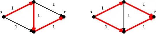

In the example below one will have to decrease flow in the middle edge to get max-flow. There is no other way.
If you want to know, if there exist a sequence of augmenting paths that never decrease the flows, then the answer is possibly yes. Proof might be non-trivial though.
