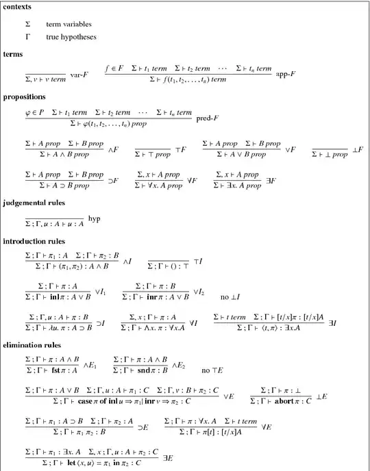

The Curry-Howard correspondence says that there is a systematic correspondence between type systems and proof systems in logic. Taking a programmer-centric view of this, you could recast it this way:
  • Logical proof systems are programming languages.
  • These languages are statically typed.
  • The type system's responsibility in such a language is to forbid programs that would construct unsound proofs.
Seen from this angle:
  • The untyped lambda calculus that you summarize doesn't have a significant type system, so a proof system built on it would be unsound.
  • The simply typed lambda calculus is a programming language that has all the types necessary to build sound proofs in sentential logic ("if/then", "and", "or", "not"). But its types aren't good enough to check proofs that involve quantifiers ("for all x, ..."; "there exists an x such that ...").
  • Dependently typed lambda calculus has types and rules that support sentential logic and first-order quantifiers (quantification over values).
Here are the rules of natural deduction for first-order logic, using a diagram from the Wikipedia entry on natural deduction. These are basically the rules of a minimal dependently typed lambda calculus as well.
First-order natural deduction
Note that the rules have lambda terms in them. These can be read as the programs that construct the proofs of the sentences represented by their types (or more succinctly, we just say programs are proofs). Similar reduction rules that you give can be applied to these lambda terms.
Why do we care about this? Well, first of all, because proofs may well turn out to be a useful tool in programming, and having a language that can work with proofs as first-class objects opens many avenues. E.g., if your function has a precondition, instead of writing it down as a comment you can actually demand a proof of it as an argument.
Second, because the type system machinery needed to handle quantifiers may have other uses in a programming context. In particular, dependently typed languages handle universal quantifiers ("for all x, ...") by using a concept called dependent function types—a function where the static type of the result can depend on the runtime value of the argument.
