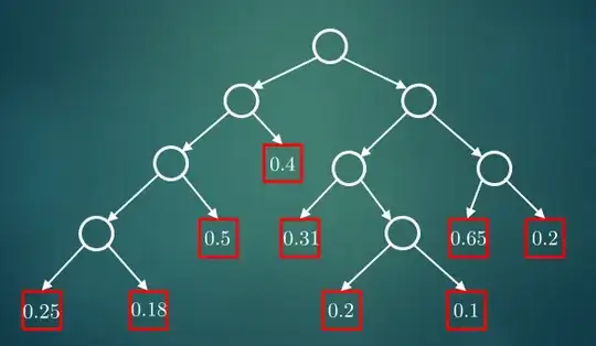

Given a full binary tree, $T$ (each node is either a leaf or possesses exactly two children), with $n$ leaf nodes: $v_1,v_2,...,v_n$, and weights associated with the leaf nodes: $w_1,w_2,...,w_n$, the cost of the tree, denoted by $|T|$, is defined as: $$|T|=\sum_{i=1}^{n}w_il_i$$ Where $l_i$ is the depth of $v_i$ in $T$.
Example:
The cost of the above tree is:
$0.25\times 4+ 0.18\times 4+0.5\times 3+0.4\times 2+0.31\times 3+0.2\times 4+0.1\times 4+0.65\times 3+0.2\times 3=8.7$

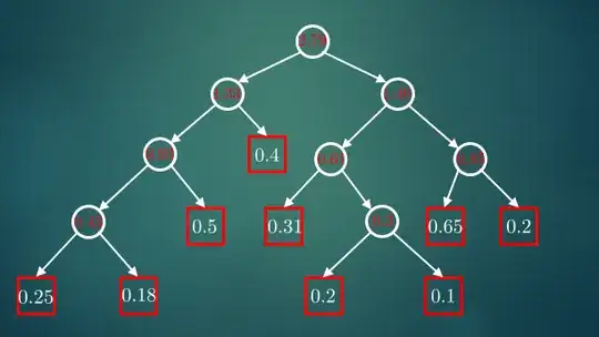

Let's associate now weights with internal nodes: the weight of an internal node is the sum of the weights of its two children.
Example:
Now for the shocker:
  1. Given a full binary tree, the sum of the $n-1$ internal nodes is the cost of the tree.
This looks surprising at first, but when you rethink about it, it makes sense (the picture above demonstrates it). My problem is proving it.
I tried proving by induction, but I got stuck in the inductive step (the base case is obvious).
Any help would be greatly appreciated.

Personally I would not prove the second statement ("the shocker") unless I was explicitly forced to do so by my professor.
The weight in a particular leaf is added to the weight of each of the nodes on the path from the leaf to the root. This is exactly the number of times the weight is counted in the cost of the tree, the depth of the leaf.
Done.
