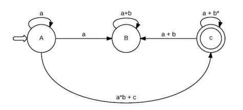

Hi, what should be the regular expression for this language ? My guess was
r = (a ∗ a(a + b) ∗ (a + b) + (a ∗ b + c))(a + b ∗ ) ∗
But the arrow from C to B is making it tough . If it was B to C then my answer would have bee correct.
Assuming that the alphabet of your DFA is $\Sigma=\{a,b,c\}$ it doesn't meet the standard definition of the transition function.
$M = \{Q,\Sigma,\delta,q_0,F\}$
$\delta: Q\times \Sigma \rightarrow Q $
If you have a valid DFA then I suggest to use a proved algorithm(like State Removal Method for example) to transform it into a regular expression.
