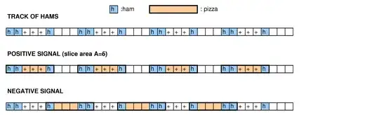

The idea is to use tracks of ham that carry positive or negative signals; the track is made with an alternation of 1 and 2 pieces of hams placed far enough so that they can be covered exactly by one slice of pizza of area $A$; the segments of the track are marked alternately with $+$ or $-$, the track will carry a positive signal if slices are cut on the positive segments:

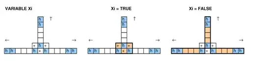

Each variable $x_i$, which is connected to exactly 3 SAT clauses, is represented by three adjacent endpoints of three ham tracks (positive segment), in such a way that there are 2 distinct ways to cut it, one will "generate" a positive signal on all 3 tracks (it reppresent the $x_i = TRUE$ assignment) the other a negative signal ($x_i = FALSE$). Notice that we can also generate mixed positive and negative signals, but in that case at least one ham remains uncovered.

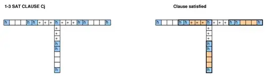

Each clause $C_j$ of the 1-3 SAT formula with 3 literals $L_{i,1}, L_{i,2}, L_{i,3}$ is simply represented by a single ham with three incoming positive segments of three distinct ham tracks; by construction only one of the three tracks carrying a positive signal can "cover" the ham-clause.

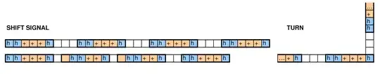

Finally we can build shift and turn gadgets to carry the signals according to the underlying planar graph and adjust the endpoints:
