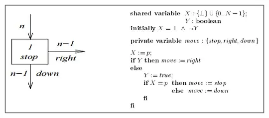

M&A use the following mutex primitive (see Figure 2 on page 5):
      Mutex Primitive
where out of n processes entering the block, at most 1 will stop there, at most n - 1 will move right, and at most n - 1 will move down.

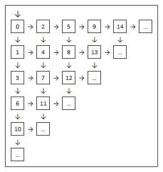

These primitives can be linked together into a grid, where I decided to number the boxes differently from M&A, to allow me to calculate the box number without knowing the total number of boxes:
      Grid
The box number can be calculated using box = (m*(m-1))/2 + r, where m is the number of total moves made (including the move into the top-left box, i.e. m ≥ 1) and r is the number of moves to the right (r ≥ 0).
Any new process will initially be assigned a large, globally unique ID (e.g. timestamp + huge random number), which it will use as the value for p in the mutex primitive algorithm above. It will then start traversing the grid following the rules of the primitive, starting in the top-left corner, until it stops in some box. The number of the box in which it stopped will now be its new process ID.
To keep the number of process IDs smaller (processes might disappear; and also: boxes can be locked forever without being used if all entering processes move either right or down and none stop there), I will replace the boolean variable Y in the primitive above with a time-stamp.
The line Y := true will then be replaced with Y := now, where now is the current time. Similarly, the condition if Y then ... will be replaced with if (now - Y < timeout) then ..., where timeout is the time after which a box will be returned to the available pool.

The loops over processes (e.g. for(j=0;j<n;j++)) will be turned into traversals of the process-ID grid from above in the order of the box-numbers. Each box can have 3 states: Never visited by anyone, a process has stopped in it, or all processes moved on and the box is currently blocked. No distinction needs to be made between the latter two, since a blocked box will simply correspond to a process that is currently not trying to enter the critical section (i.e. ai, wi, and si are false/expired). The loop starts in box 0. If it comes across a box that has been visited (i.e. has its X-value set), it adds the adjacent boxes to its "to-check-list" (i.e. if box 8 was seen, box 12 and 13 will be added to the list). The loop terminates when the "to-check-list" has been processed completely (unless, of course, there is another stopping condition present that fires first (e.g. j < i or & !aj)).
