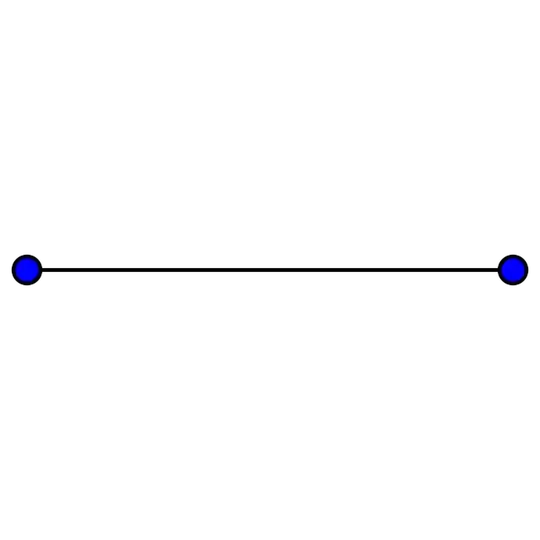

However, there's a problem: Say n=3 and we are currently considering the graph P2:

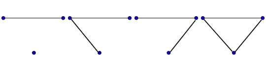

Now there are 4 ways to add a third vertex: enter image description here
However, two of them create the same graph, P3. Using a canonical labeling as explained above doesn't solve this issue. So the extensions themselves need to be canonical, somehow. I assume I need to use the automorphism group of the graph of size n-1 somehow.
So that's my question. How can I make sure that all my extensions give non-isomorphic graphs?
