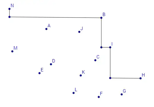

$O(N \log N)$ solution
To construct solution with $O(N \log N)$ time-complexity, let see some example of sets $S = \{A, B, C,..., N\}$ and $M = \{N, B, I, H\}$: answer
To find $M$ we need to sort points in $S$ by $x$ in descending order, and if $x's$ the same by $y$ in descending order (it can be done in $O(N \log N)$, let call this sorted list $L$.
  1. Include first point from $L$ in $M$ and remember this point as $T$.
  2. Iterates through $L$ (let $C$ current considered point from $L$):
    • if $C$ is dominated by $T$ than skip $C$ and go to next point in $L$;
    • else include $C$ in $M$ and set $T = C$ This step can be performed in $O(N)$.
