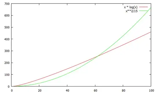

the question and answers have a lot of notation. how about a picture, "worth a lot of words" and some zen-like visual/ geometric intuition? this is a simple graph of $x \log(x)$ (red) vs $x^2/15$ (green). rest of explanation (of the graph vs big O notation, etc) left as exercise to reader (eg also solve for exact region where one is supposedly "faster" than another etc, and reformulate the functions slightly so that it matches the constants $C,k$ in the question, etc).
