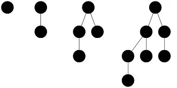

Addendum: How can we come up with Fibonacci trees if we had not overheard a professor mentioning them? Well, what would an AVL tree of height $h$ with as few nodes as possible look like? Certainly, you need a root. One of the subtrees needs to have height $h-1$, and we have to choose it with as few nodes as possible. The other one can have height $h-2$ without violating the height balancing condition, and we choose it also with as few nodes as possible. In essence, we construct the trees we want recursively! These are the first four:
First four Fibonacci trees
[source]
We set up a recurrence for the number of nodes $f(h)$ in the thusly constructed tree with height $h$:
$\qquad \displaystyle \begin{align*} f(1) &= 1 \\ f(2) &= 2 \\ f(h) &= f(h-1) + f(h-2) + 1 \qquad n \geq 3 \end{align*}$
Solving it leads to $f(h) = F_{h+2} - 1$ which we used above.
