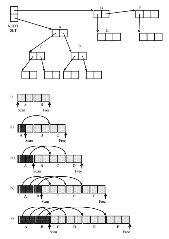

In "classic" descriptions of garbage collection (e.g., Mark Wilson, "Uniprocessor Garbage Collection Techniques", Int'l Workshop on Memory Management, 1992, (alternate link), or the description in Andrew Appel's Modern Compiler Implementation (Cambridge University Press, 1998)), collectors are classified as either "Mark and Sweep" or "Copying".
Mark and Sweep collectors avoid needing extra space by using pointer-reversal, as described in @Gilles's answer. Appel says that Knuth attributes the pointer-reversal algorithm to Peter Deutsch, and to Herbert Schorr and W.M. Waite.
Copying garbage collectors use what is often called Cheyney's algorithm to perform a queue traversal without needing extra space. This algorithm was introduced in C.J. Cheyney, "A Nonrecursive List Compacting Algorithm", Comm. ACM, 13(11):677-678, 1970.
In a copying garbage collector you have a chunk of memory that you are trying to collect, called the from-space, and a chunk of memory that you are using for the copies called the to-space. The to-space is organized as a queue with a scan pointer pointing to the oldest copied-but-unscanned record, and a free pointer pointing to the next free position in to-space. The picture of this from Wilson's paper is:
Cheyney's algorithm example
As you scan each item in to-space you copy its children from from-space to the free pointer in to-space, and then change the pointer to the child from from-space to the new copy of the child in to-space. There's an extra trick you need to use when your data structures aren't trees (when a child can have more than one parent). In that case, when you copy a child from from-space to to-space you need to overwrite the old version of the child with a forwarding pointer to the new copy of the child. Then if you ever scan another pointer to the old version of the child you realize that it has already been copied, and don't copy again.
